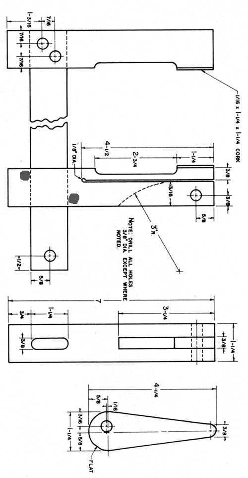

Here's a plan, just change for the depth you want.
Rod True38854.9964814815

Rod, about your drawing -- I'm thinking the cammed jaw is still gonna need a couple of pins, staggered, on each side of the bar. Or else it will probably slip. I used roll pins on the ones I made.

[QUOTE=Michael McBroom] Rod, about your drawing -- I'm thinking the cammed jaw is still gonna need a couple of pins, staggered, on each side of the bar. Or else it will probably slip. I used roll pins on the ones I made.
Best,
Michael
I agree. That's really where you get the "power" of the clamp. If your camming action causes the bar to dig into the wood, you've sort of lost the functionality.

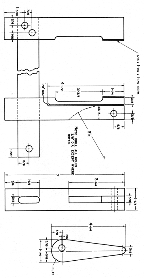

Just so you all know, I've never built a cam clamp in my life and the drawing I found on the net somewhere a long time ago, it's not mine .
But I'm sure it will be a good start.
So... Please edit the drawing as per the real pros here.
That would be Mr. Paul Woolson.
So like this you guys?
Rod True38855.6740162037
